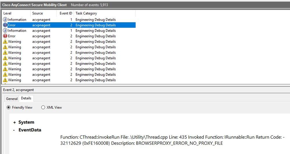

First I would try opening a powershell or cmd prompt as an admin and run the specific installer for the module you need, if you just need the VPN client just run the core VPN msi. Tried just running the VPN MSI and got an error (attached below)
If that doesn't work there may be an issue with the installation, I found that when something like this happens you need to go into the registry search for any keys/hives with AnyConnect in the name and delete them entirely. After removing the registry entries reboot and try reinstalling. Deleted the installation package from my laptop and then went and removed anything with 'AnyConnect' and 'Cisco' in the registry. Rebooted, re downloaded the package (noting the package isn't just a random online one - it's on the FTP server of the client I'm working for and everyone else has downloaded and run this package successfully). Then I tried to re-install, exact same issue. I have attached some screen shots of the event log with the error messages received - perhaps this will help provide some more advice as I'm at a loss.

I had same issue ......i just removed my antivirus (Symentec) and restart Laptop then i install anyconnect modules and got no issue at all......So try uninstalling antivirus if you have.Thanks
Hi downsouth212, Try this guide. check will help to you. http://www.microsolutions.com.lk/cisco-anyconnect-installation-failed-with-prematurely-error/ regards,
