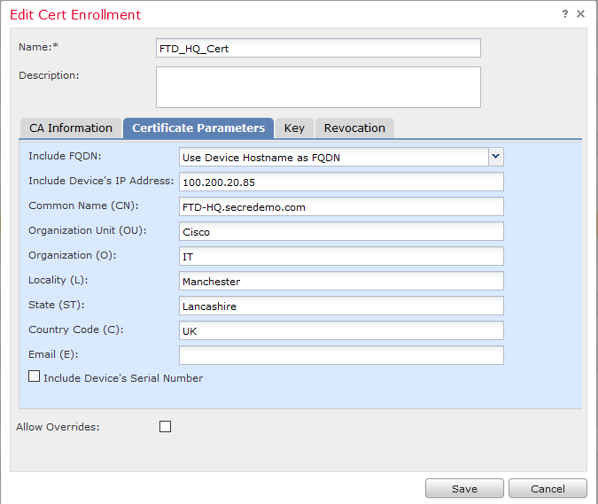

Hi never did SCEP I have expeirnce doing with manual enrollment. so might this help you. I know you asking for SCEP.
PKI-->Cert Enrollment Add Cert Enrollment
Than go to Devices ---- Certificates  you will see Add (button) on the right top hand side. it will bring up a topup "Add New Certificate"
here you will call your FTD-HQ-Cert (Cert Enrolment) once the cert is uploaded. you will generate the CSR. To generate the CSR you will click on the "ID". once you have the CSR you have to take it to your CA and get it signed. Incase you have root CA and intermediate CA in that case you must have to enroll both of them as mentioned in PKI.

Yeah, this was the second of 10 different attempts I tried. It should be noted that only Self-signing has worked on the device, and this is unacceptable.
