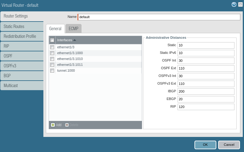

Basically here is my configuration for Cisco Side (I'm also attatching screenshots of Palo Alto configuration below in attached messages)

Attached Palo Alto side config'sIKEv2_Gateway.pngIKEv2_Phase1.pngIKEv2_Phase2_IPSEC.pngIKEv2_Phase2_IPSEC_2.pngIPSEC_Tunnel.pngIPSEC_Tunnel_proxies.pngRouting.pngRouting_2.png
