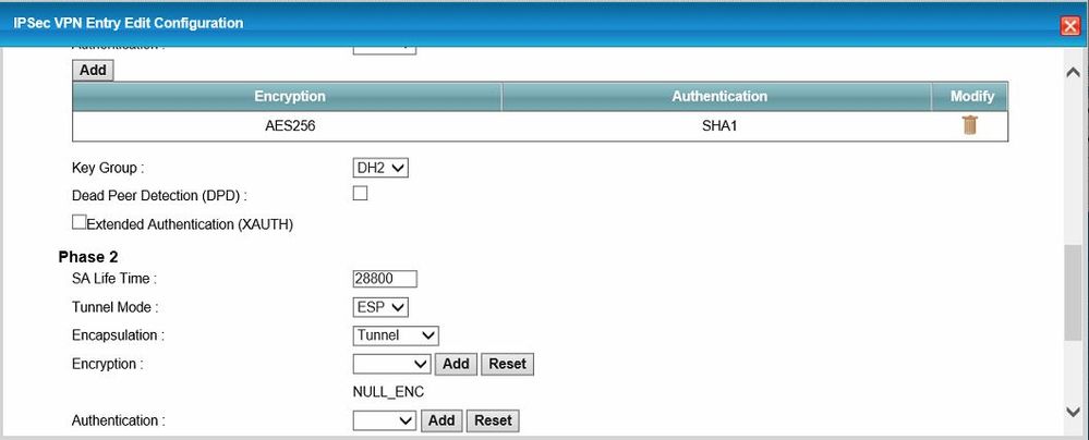

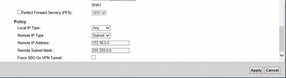

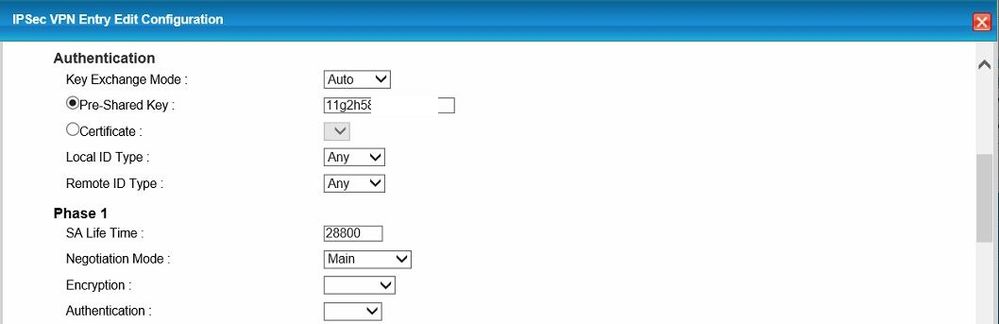

i have a problem with site 2 site vpn connection behind HQ cisco asa 5545 ip 0.0.02.82 and Zyxel SBG 3300 ip 0.0.0.133.
I dont know how to configure this zyxel router.
Phase 1 is complete. There is log from asa:logasa.JPG
 I try everythink on configuration, now my configuration on ASA look like this:S2S connection profile 1S2S connection profile 1
S2S connection profile 2S2S connection profile 2
S2S connection profile 3S2S connection profile 3
And configuration on Zyxel:zyxel1.JPG
I hope that this printscreen will help you to find some mistake in my configuration.
I will be grateful for any help!
Thank you very much.
Best regards
Filip

Hi becfip,
Checking the config of the ASA and also the Zyxel i found the following:
-The interesting traffic need to be mirrored between the 2 devices:
ASA= any to <destination>
Zyxel= <local> to any
If after matching the config you still get any issue you can run the following debugs through the CLI:
debug cry condition peer <zyxelpublicip>
debug cry isa 180
You can share the sanitized logs here.
Hope this info helps!!
