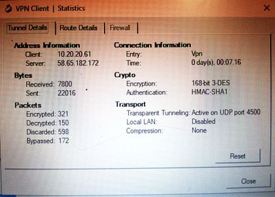

Hello everyone
 I Need Help. I configured remote vpn settings on my cisco router 1812 . I can connect to the VPN successfully but no internet access and Lan access . I attached the VPN client statistics.
