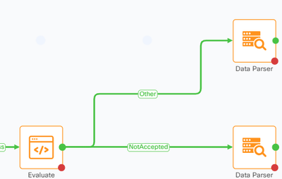

Let say node X has 3 outputs.
I can drag 1 of the outputs from node X to node Y, but when I try the other outputs from Node X to Node Y, it just won't 'connect'. - and defaults to Release End Node.
It will allow it to be connected to other nodes? Anyone else experience this issue?
I don't have any workaround apart from deleting the node which you cannot connect to and recreate it - which is very time consuming.
Example below where Output from the Evaluate won't "connect" to the Data Parser node.

@Gerry O'Rourke , eval and data parser (your examples) can not have 2 different connections between them. The output of eval has to go to 2 different nodes as what you see in your image. Depending on your use case (I have seen it done for other reasons) you may be able to insert a "dummy" eval node that does nothing.

Steve,
Is this documented somewhere, what are the restrictions at the node level?
Gerry
@Gerry O'Rourke , most of the restrictions are listed here: https://help.imiconnect.io/docs/nodes  I am not sure why double connections is not among those, I will suggest that it gets added.
stgreenb
While I do know there are some use cases where this is the right logic, two nodes can not be tied together with multiple connections.
Gerry O'Rourke
Actually - even creating a new node doesn't help.
I had to create two copies of the node to allow it to connect?
Gerry
