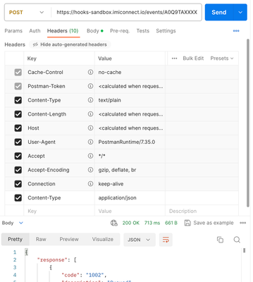

I am trying to configure a webhook as a trigger for my flow but i am unable to get it to work. When i try to send test requests using postman, it does not get invoked or the variables do not get parsed.. is there additional steps needed to get this to work? I tried with and without authentication, the response to postman is always 400 Bad request.

Hi @sthan89 - I just tried triggering an inbound webhook and was able to successfully able to do so using my Sandbox account. Here are some reference screenshots. Let me know in case you continue to face this issue.
I didn't configure any authentication details for this test trigger.
Hope this helps!

Thank you Tanuj, it appears the headers was the cause for my issues. I had removed Host, Content-Length from my requests before. Once i added them back, i see the same response as you.
