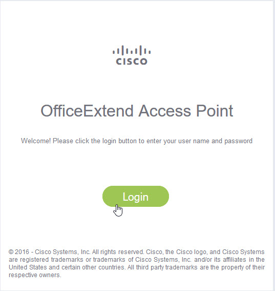

Hi Everyone !
I have an issue with Cisco 1832i AP. I already set the SSID for my AP. PCs and Mobile Phones also connected to my AP and could access the internet. But, when I tried to access the AP's IP address for manage some config, I can't login to it. Nothing happen when I clicked the Login Button.
Can anyone help?
Thanks before.

I've try to factory reset and re-install the flash image. But it comes with same result. The login button can't be pressed.
But one thing that I want to know, why it show as "Office Extend Access Point", not "Wireless LAN Controller" as show in the guide?
(http://www.cisco.com/c/dam/en/us/td/i/400001-500000/400001-410000/406001-407000/406339.tif/_jcr_content/renditions/406339.jpg)
Thanks.
That's a known issue.  If you search the forum for Mobility Express OfficeExtend login you will find additional information. Have you tried to open a TAC case?
