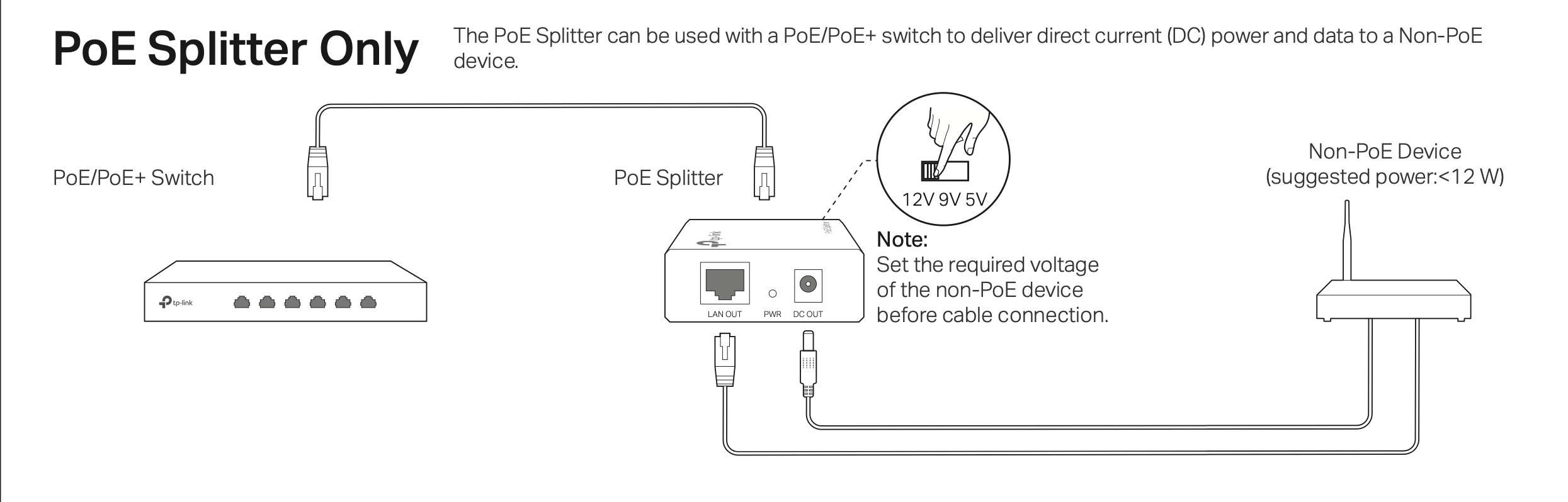

I've seen this setup before for non-PoE capable devices. The PoE splitter takes the 48V supplied by the switch and converts it to the right voltage for your device - something like the one in the attached screenshot.
I've seen devices that work with this setup and others that do not power up - like your modem - using the same PoE splitter and PoE switch.
Regards, LG

Thanks LG I'm now thinking that it may be a compatibility issue between my splitter and the switch. I'm going to check this with the manufacturer of the Modem/Enclosure. But thanks again.
In case anyone has this issue in the future I've found this which looks quite cool and am going to give it a go:
Ubiquiti 802.3af 48v to 24v passive POE converter
