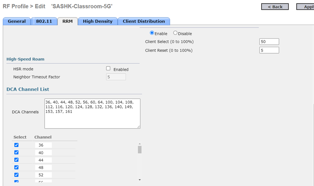

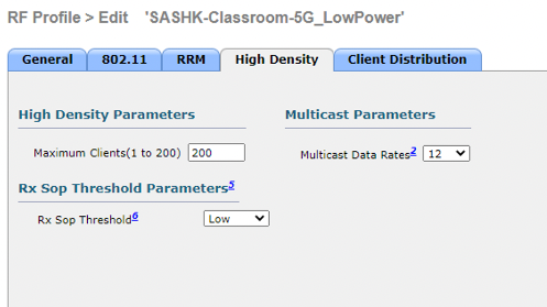

I have a customized RF profile:
Screenshot 2022-09-23 at 8.35.22 AM.pngScreenshot 2022-09-23 at 8.35.46 AM.pngScreenshot 2022-09-23 at 8.35.59 AM.pngScreenshot 2022-09-23 at 8.36.10 AM.png
How can I influence client A to prioritize connecting to its own classroom AP?

McArenas
Sharing my new RF Profile, in case, anyone would need it:
Screenshot 2022-09-26 at 8.43.23 AM.pngScreenshot 2022-09-26 at 8.43.35 AM.pngScreenshot 2022-09-26 at 8.43.46 AM.pngScreenshot 2022-09-26 at 8.43.52 AM.png

McArenas
@JPavonM  @Leo Laohoo
Thank you both for your reply.  I have tweaked the power settings and data rates 6,12 and 24 Mbps to Mandatory as suggested by @JPavonM . It seems to be working well.  This is the first time that our problematic client, "Client A", has been associated with her classroom AP without any ping pong! This could have actually solved the issue.  I will keep everyone posted on this thread.  This is the first day and I don't want to jinx it. But so far, very happy with wifi today. It feels really snappy.
Thank you so much for your help!
McArenas
