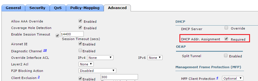

Hi Peter,
Under WLAN Advanced configuration, there is a tick box for allow DHCP address, if you tick that option, then static client won't be allowed
I would suggest you to test your client to be DHCP & see if it get IP from /22 network you mapped
HTH
Rasika
*** Pls rate all useful responses ***
