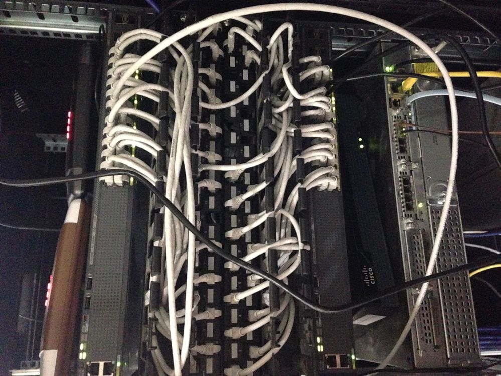

HI MARK
here u are picture from live and were the wireless ap connected to port on switch cisco catalyst 2960-x 24 gige poe 370w 4 x 1G sfp lan
amr alrazzaz
Hi that's not really going to show anything its just an LED , do you have cli access to collect information ? need to see the actual output from the switch show interface x/x where the wireless router is connected to se if its being overloaded

amr alrazzaz
and this is the mac address for AP
1491.821b.bc39 DYNAMIC Gi1/0/18
amr alrazzaz

That's an output of the MAC table and the VTP , I asked for 1 command show interface g1/0/18 where the wireless controller is connected to see what the load is on the interface and if it has errors incrementing
For security reasons please delete the passwords in the post you uploaded , vty and enable passwords

Ok so the interface is perfectly clean no errors to indicate its being overloaded at all with traffic or it would show issues overruns and output drops
Its only 100mb though is the wireless routers ports only 100mb ? if its capable of a 1gb you could hard set the port
Issue is not on switch side , does the n300 AP have a  MGMT  ip address ?
it has yes but i cant access it because
its configured from previous employee , so can i reset it and reconfigure again .... but the port is Ethernet 100mbps and switch port is 1000mbps so if i change the AP to gigaethernet port maybe it will fixed?? thats what u r trying to say to me ?
thx for ur great support sir

no I'm not saying that will fix it , but it would be better to be 1000mb than 100mb for throughput
You need to access that wireless device as it may be the problem , if it has a management ip address you can run an extended ping to it and then run and extended ping to the far end of the circuit ip address see which ones drops first , if its the circuit and the AP is still pinging it could be the circuit itself that's flaky  , are you monitoring the circuit at all with any software ?
You said users face this issue when on wireless and the circuit drops , what about if you connect a user directly wired to the router do they have the same issue ? This will rule out the wireless part of the router as being the issue
