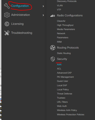

Thank you Flavio for your reply. do you me mean the below "Configuration" . I cannot see "Priority Order"
oh sorry, you said WLC 9800 and I though AIROS WLC.
For 9800 you can check on the AAA, TACACS+ / AAA Method List, the default option must be reffering to your TACACS server.
Type login and type dot1x. The first is access to the WLC and second is for Wireless users
