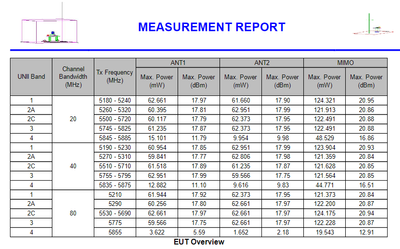

To prevent issues with distance between AP and devices you need to avoid power impairment. If AP Tx Power exceed that on the client device, then you would have a problem. Antennas only add gain to the signal in the both directions, but if the maximum Tx power from client (which you cannot control in smart devices) is from a value that after adding antenna's gain it doesn't match that from adding Tx Power plus gain on the AP side, then it is likely that the client device won't be heard  by the AP.
If you don't know the maximum transmission power from the device, most of the times you can check that from the FCC site using the FCCID code on the device's label.
For example check this from a Samsung S22 device:
https://fcc.report/FCC-ID/A3LSMS901U/5567252
