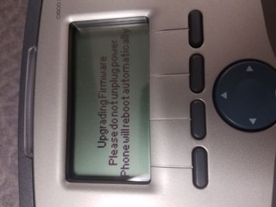

See the picture below. Once and hour, all 20 of my phones will do this. It lasts about 10 seconds. From time to time it will also say initializing network. Please help!phone.jpg

The picture is a message that all phones display. It states: Upgrading Firmware Please do not unplug power Phone will reboot automatically.
All phones do this once every half hour
