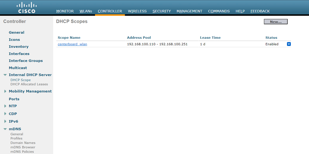

Can you share screen shot of dhcp config

here are my shotz
cisco_wcl_wlan_dhcp6_flex_2023-11-28 10_32_03-cbag_wlc - Brave.pngcisco_wcl_wlan_dhcp5_2023-11-28 10_32_03-cbag_wlc - Brave.pngcisco_wcl_wlan_dhcp4_2023-11-28 10_32_03-cbag_wlc - Brave.pngcisco_wcl_wlan_dhcp3_2023-11-28 10_32_03-cbag_wlc - Brave.pngcisco_wcl_wlan_dhcp2_2023-11-28 10_32_03-cbag_wlc - Brave.pngcisco_wcl_wlan_dhcp1_2023-11-28 10_32_03-cbag_wlc - Brave.pngcisco_wireless_controller_2023-11-28 10_30_18-cbag_wlc - Brave.png
with these settings I (unfortunately) do not get an IP address assigned in the WLAN
