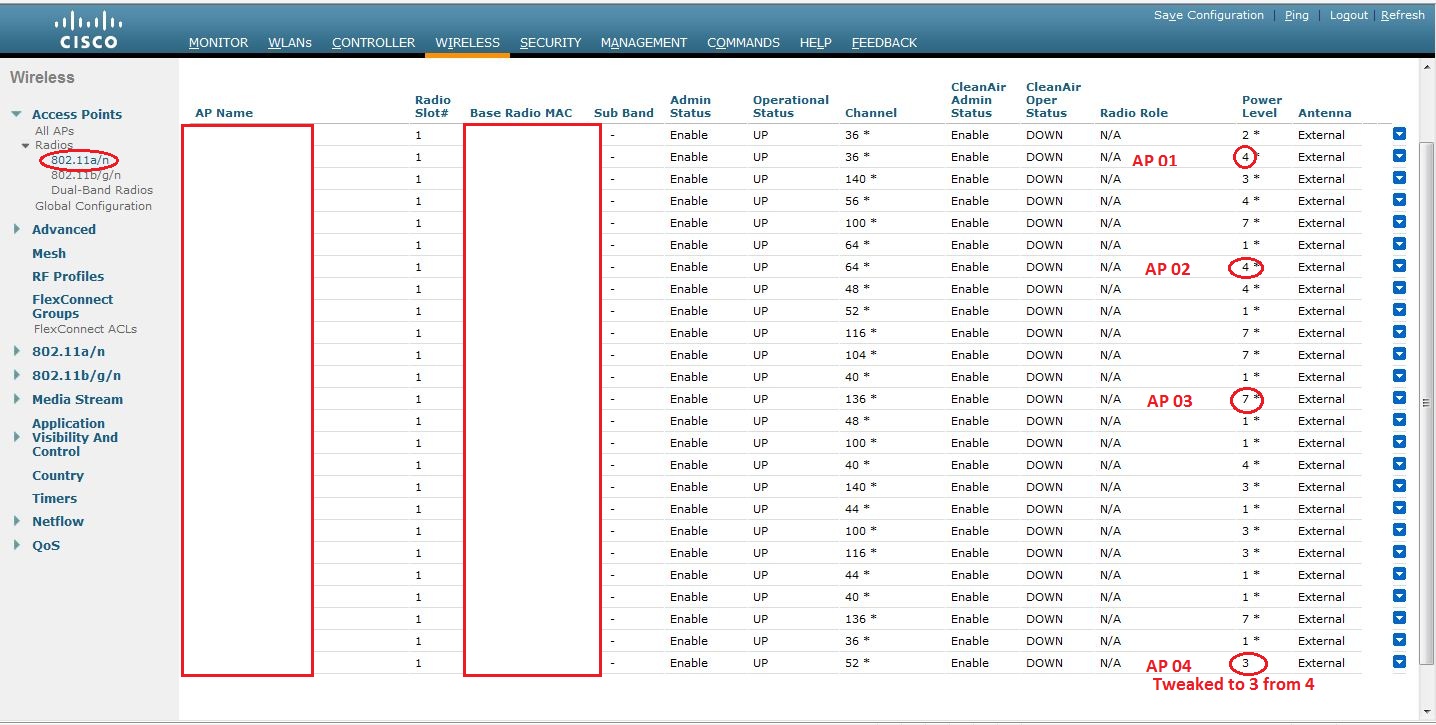

I am attaching 2 screen shots of the hallway APs (circled) in b/g/n and a/n showing the Transmit levels. I have tweaked one AP tx level only (circled, changed form 4 to 3 under a/n) but didnt get the time to see the results.
