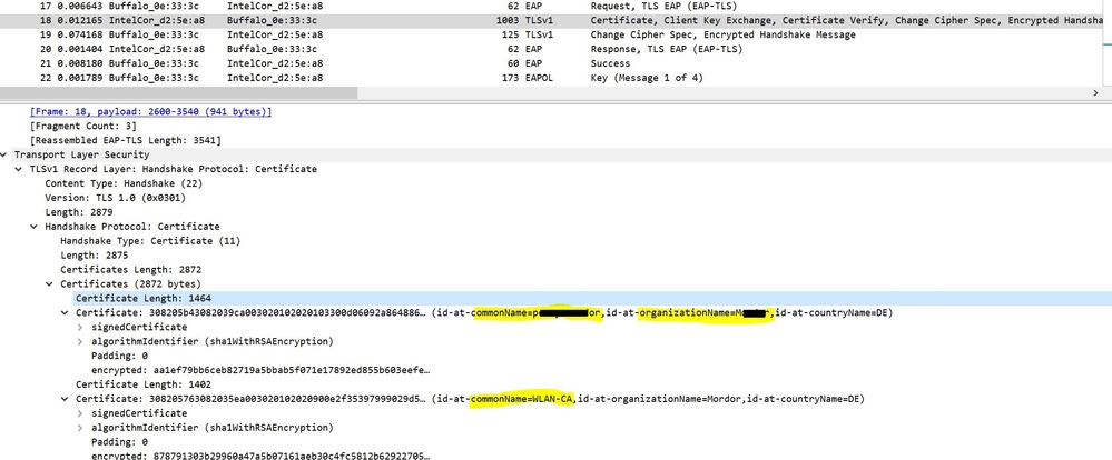

ammahend
some of this information is also present in client certificate, you can get it simply by wireshark capture over air, see the example enclosed where one can see client information that you mentioned over wireless.
As other mentioned MFP and WPA3 will address some the issues related to protecting management frame exchange.
the information itself can not be used for authentication, but can certainly be useful for reconnaissance
