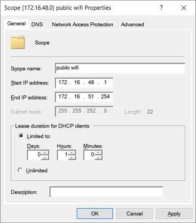

Did you check DHCP scope with the correct subnet defined on DHCP server for vlan 900?  Also check that Public WiFi is mapped to vlan900 interface on WLC
HTH
Rasika
Both look ok?
