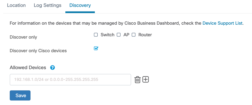

Why is it so difficult to delete hosts that appear in the network discovery? I've been struggling to delete the hosts shown in the attached image. I have the host option checked off in the overlay settings and I have also blocked the discovery, which is why the hosts now appear with the red 'X' but when I select the host, the option to delete is greyed out. Any solution for this?

Thank you for the reply, yes I was aware that those 2 catalyst switches were not devices supported on the CBD. I was trying to play around with the discovery settings but was unsuccessful. It would be nice if i could only see switches and access points on the typology and nothing else. No need to see the devices connected to the switches and access points.

I will try to remove the hosts in 2.7.1 release for this case, but can't make sure the right connection between switches and access points since there are unsupported catalyst switches in your env.
