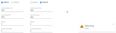

I have installed new DNAC on our VM infra with DNAC-SW-2.3.7.5-VA.ova image. I have integrated our ISE with DNAC, and now I am trying to make the GUI authentication through Tacacs. While checking the External Authentication on Users/roles in DNAC  on the AAA servers I am seeing the update option to be freeze(attached image) and not able to change to tacacs.Does anyone help me with this..? Is it kind of bug on the software..?

1. The update button will not let you click it until you put in the shared secret. You have to do that each time you want to change anything in the advanced settings section for the Primary and/or Scondary AAA server options in Users and Roles → External Authentication.
Although the section looks like the shared secret is already there, that's just a default view, there is no content in the shared secret box, unless you input it first.
2. There were a lot of known issues with External Auth in the OVA for 2.3.7.4 and 2.3.7.5. I would suggest upgrading to 2.3.7.6 as this fixed the majority of them. Without further information, there is no telling what may be causing the error as it could be service related or integration related with Cisco ISE.

Yes, I can see the update option if I enter the shared secret ,but once I provide the secret and try to change it to Tacacs, it is throwing an error and again reverting back to radius.Same case repeats for Seindary AAA as well
Could you pls help me with this, I have tried to delete and re add the ISE in authentication/policy servers, but still no luck.
I would strongly suggest upgrading to 2.3.7.6 or 2.3.7.7 as this is probably one of the external authentication issues that existed in 2.3.7.4/2.3.7.5 that were fixed as part of the upgrade path.
