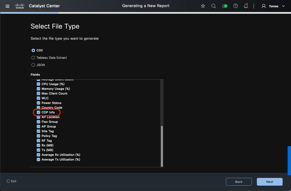

From what you are asking, you can find everything you need in the Report for APs. The "Last Disconnect Time" will correlate with the "Uptime" value. Just subtract the uptime days from the day that your ran the report and you should have your Last Disconnect Time. This of course is tied together since most Cisco APs are connected to a Cisco Switch in which POE is used.
  • Using the Cisco Catalyst Center Admin UI, Go to the Reports Page
  • Select Report Templates
  • Select Access Point Category
  • Select the "AP" Card and Click Generate
  • Proceed through the Report Work flow and Click "Generat Report"
  • When the report is completed, you can download the .CSV File (if selected) and review the CDP Neighbors of the inventory managed Access Points
For Example:
For Example:
