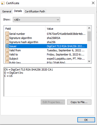

Can you open the expressway cert and go to "Details" and make a screenshot of the "issuer" and "enhanced key usage"?
These are the screenshoot of expressway cert issuer and enhanced key usage
Have you tried to export the CA's from the expressway cert and upload those certs into expressway?
In the expressway cert go to "certification path" and export the CA's.
Maybe a reboot helps too. Looks a bit weird.
thanks, after export the CA's from expressway cert and upload it to trusted CA certificate, i can upload the expressway cert into server certificate.
Glad to hear that.
Maybe something was wrong with the CA's which you got. Whereas, if you export them from the certificate, normally is the safest way to get the "correct" CA's.
