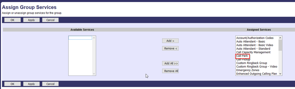

Configure Call Park on Broadworks
  1. Login to you Broadworks platform
  2. Navigate to Resources --> Assign Group Services
  3. Add “Call Park” to Assigned Services

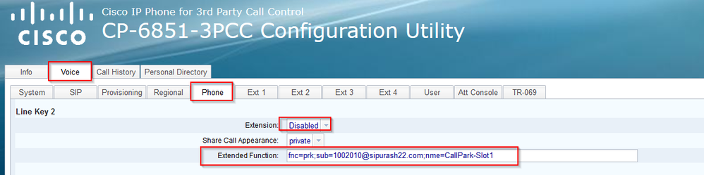

Add Call Park to a Programmable Line Key and Key Expansion Module Line Key
In addition to using the service activation codes and softkey, you can also add a Call Park to a Programmable Line Key or Expansion Module Line Key.
  1. Login to http://IP_ADDRESS_PHONE/admin/advanced
  2. Navigate to Voice --> Phone
  3. Chose which Line Key you would like to use (Line Key 2,3,4 etc.. )
  4. Under Extension, set it to “Disabled”
  5. Specify the Extended Function using the following format:
    1. fnc=prk;sub=$USER@$PROXY;nme=CallPark-Slot1
      1. ie: fnc=prk;sub=1002010@sipurash22.com;nme=CallPark-Slot1
