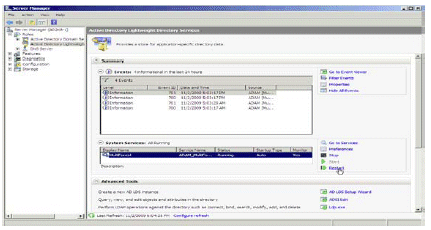

Install the Instance for Multiple-Forest Support
AD LDS can run different instances of the services with different ports, which allows for different user directory “applications” to be run on the same machine. By default, AD LDS chooses ports 389/LDAP and 636/LDAPS. If the system already has any kind of LDAP services running, however, it uses ports 50000/LDAP and 50001/LDAPS. Each instance has a pair of ports that increment based on the previous numbers used.
In some cases, due to a Microsoft bug, the ports are already in use by the Microsoft DNS server and the instance wizard shows an error, which is not self explanatory. To resolve this error, reserve the ports in the tcp/ip stack. If you find this problem, refer to AD LDS service start fails with error "setup could not start the service..." + error code 8007041d leavingcisco.com.
Perform these installation steps:
  1. In the Server Manager, choose Roles > AD LDS.
  2. Choose Click here to create an AD LDS instance.
    Figure 16: Active Directory Lightweight Directory Services Window

  15. Update the schema and restart AD LDS.
    Figure 43: Update Schema Now
    Figure 44: Restart AD LDS
