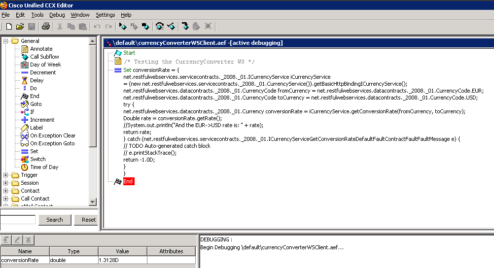

9. Let's create a script to test the WS functionality. One variable, of type double, will be needed. Name it conversionRate.
Then insert a Set step, where the return value would be the conversionRate variable, and the value is the following code block:
net.restfulwebservices.servicecontracts._2008._01.ICurrencyService iCurrencyService
        =  (new net.restfulwebservices.servicecontracts._2008._01.CurrencyService()).getBasicHttpBindingICurrencyService();
         net.restfulwebservices.datacontracts._2008._01.CurrencyCode  fromCurrency =  net.restfulwebservices.datacontracts._2008._01.CurrencyCode.EUR;
         net.restfulwebservices.datacontracts._2008._01.CurrencyCode  toCurrency =  net.restfulwebservices.datacontracts._2008._01.CurrencyCode.USD;
        try {
             net.restfulwebservices.datacontracts._2008._01.Currency  conversionRate = iCurrencyService.getConversionRate(fromCurrency,  toCurrency);
            Double rate = conversionRate.getRate();
            //System.out.println("And the EUR->USD rate is: " + rate);
            return rate;
         } catch  (net.restfulwebservices.servicecontracts._2008._01.ICurrencyServiceGetConversionRateDefaultFaultContractFaultFaultMessage  e) {
            // TODO Auto-generated catch block
            // e.printStackTrace();
            return -1.0D;
Remember, this was the program we tried before in Eclipse, with some modifications. For instance, if an exception is throw, we return -1 (or, more precisely, -1.0D) so the rest of the script knows there was an exception.
Take a deep breath and try to do a "Step Over" type debugging. If you see a non-negative value assigned to the conversionRate variable, congratulations, go out and celebrate.
image2012-9-16 22:10:36.png

Thank you for this post.  I'm trying to follow along, but the images are missing.  Would it be possible to rectify the issue?
Thanks!
Gergely Szabo
Hi Michael,
must be something wrong with this forum engine. When I switch to edit mode, I can see the images.
Anyway, I will try to re-upload them to here again tomorrow.
G.
Gergely Szabo
Michael,
I am afraid I can't fix it by reposting the images - I can't find them anywhere.
However, I am ready to help you with this, can you please contact me privately and give me some details about your project. Thanks.
G.
