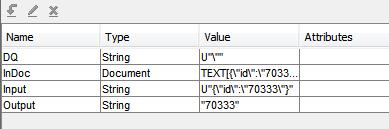

Your JSON data needs to have the data be in double quotes as well as the id
The back slash is the normal Java escape character for the double queue and does not cause a problem
This little script works OK and extracts the 70333
Graham

Thanks Graham!
Tried that out and it works as well.
