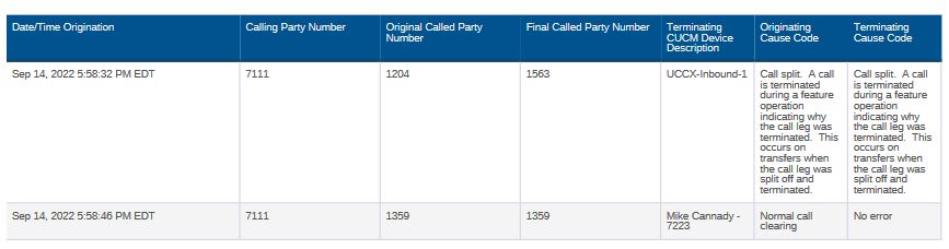

Strange issue, I have one person (so far) that is using Cisco IP Communicator and cannot 4 digit dial into any of our UCCX queues. I myself use the Cisco IP Communicator and I can 4 digit dial them fine. He is however able to reach them when he 10 digit dials. When the user calls the 4 digit number for the helpdesk instead of getting put in the queue, he gets a busy signal. He has tried this when he is both remote and on campus, same issue. I did DNA on his number and it routes it exactly like mine. I ran a report in Variphy showing my call vs. his call. My call breaks of to a transfer to the CTI route point, but his says Resource unavailable, unspecified (See attached screenshots of Variphy report). I have had multiple others test this with no problems, at this time he seems to be the only one. Any thoughts? Below is the DNA from his number. I am also attaching screenshots of the 2 call examples

That is strange. Are you able to try from their desktop and configure it with your IPC and dial, just to eliminate if it was something tied to their laptop (or vice versa)?
I will give it a try tomorrow if he will allow me the time. I will report back on my findings! Thanks
Great suggestion! I loaded that users IPC on my laptop and was successfully able to place the same calls that he could not.
