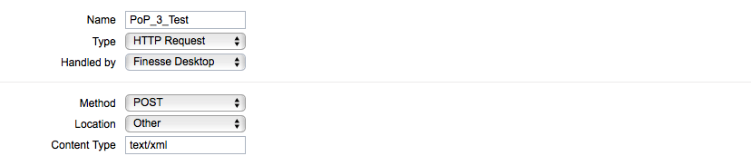

The main objective here is to pass Data along in the Body of an HTTP request to a SOAP service to communicate with Mainframe for a Screen Emulator Pop.
If I use a tag like this within the snippet of code outlined below   <q0:agent_id>${callVariable2}</q0:agent_id> I get an API error
However if I put  <foo>${callVariable2}</foo>  *like in the dev guide* The call goes through However nothing displays in the variable info even when I see in the logs that Variable data is passing...

Ah ha! Looks like when you manually put ${callVariableX} between the tags, it makes it a literal string.
This is my workflow configuration where agent_id is manually and the test is a tag:
The logs show that the post body is:
<soapenv:Envelope xmlns:q0=\"http://www.GCS0012CI.com/schemas/GCS0012CIInterface\" xmlns:soapenv=\"http://schemas.xmlsoap.org/soap/envelope/\" xmlns:xsd=\"http://www.w3.org/2001/XMLSchema\" xmlns:xsi=\"http://www.w3.org/2001/XMLSchema-instance\"><soapenv:Header></soapenv:Header><soapenv:Body><q0:GCS0012CDATA><q0:input_fields><q0:agent_id>${callVariable3}</q0:agent_id><test>alphanumeric12345</test><q0:call_num>12345</q0:call_num></q0:input_fields></q0:GCS0012CDATA></soapenv:Body></soapenv:Envelope>
where alphanumeric12345 is the value of callVariable3.
So let me know what API error you are getting when you use the tags rather than manually typing it in and we can go from there.

Ok so I set up another workflow so I didn't confuse the two. Doing exactly what you had suggested. Attached is the screenshot and the logs.
New Logs
Dropbox - Cisco_Log_5_4_17.txt
From the logs it appears to not have the \  but I still don't see the data populate it's just the code... Is this the way it's supposed to look like?
I'm getting back a 504 error this time.
