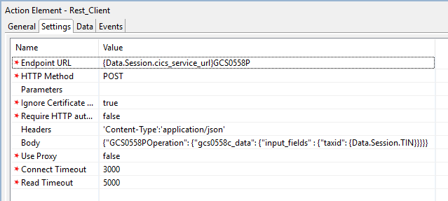

REST Element in CVP Call Studio 11.6 - Commas stripped out of the JSON response body
lisa.ferraro
We are using the REST Client element to call a service that returns JSON.  I am trying to parse a JSON response where we have to use POST to call the service.  It appears I am unable to parse the response.  When I write the response to the activity log, there are not any commas between output fields. When I test with Postman, the response contains the commas.  Would the REST Client element be stripping the commas off the response or do I have something incorrect when calling the service (screen shot of element below)?  When I enter the response that is in the Activity log on http://jsonpath.com/, it errors until I add the commas between the output fields.
Activity Log:
{"GCS0558POperationResponse":{"gcs0558c_data":{"output_fields":{"excp_msg":"SUCCESSFUL ""excp_number":0"verified":"Y"}}}}
Postman:
    "GCS0558POperationResponse": {
        "gcs0558c_data": {
            "output_fields": {
                "excp_msg""SUCCESSFUL                                                                                                              ",
                "excp_number"0,
                "verified""Y"
Thanks David!
I forget about the debug functionality in Call Studio.  Great idea to create a separate application to move code into for debugging.
The response body displays correctly with the commas in the debugger.
I finally determined my issue when trying to populate session variables from the Set Value element I was using to parse the response body.  I was referencing Element Data, thinking the variables would be created there, instead of using the Local Variables.

david.macias
I don't have a POST endpoint which returns any long JSON at my disposel, but I do have a GET which returns a massive JSON string and I see the commas. I did this through the same CVP Studio you're running. If you put that element in it's own application and do a debug session, do you see the right data in the debug? I'm wondering if the issue is with the write to log.

Thanks David!
I forget about the debug functionality in Call Studio.  Great idea to set up a separate debug application that I can move code in and out of.
The response body displays correctly with the commas when I debug the element.  So my Set Value element is not parsing response correctly. Maybe I have the syntax incorrect?  I verified the path displays the value using http://jsonpath.com/.
localProviderExcpMsg:
importPackage(com.audium.server.cvpUtil);
var jsonResponse = {Data.Element.Call_Provider_CICS_Service.response_body}
var path = "GCS0558POperationResponse.gcs0558c_data.output_fields.excp_msg"
var result = JSONPathUtil.eval(jsonResponse, path);
result //return the result of the JSONPathUtil.eval into the local variable.
localProviderExcpNumber:
var path = "GCS0558POperationResponse.gcs0558c_data.output_fields.excp_number"
localProviderVerified:
var path = "GCS0558POperationResponse.gcs0558c_data.output_fields.verified"
If you're still having issues with the parsing of the JSON this person seems to have had the exact same question as you. https://community.cisco.com/t5/contact-center/cvp-set-value-element-json-parse-array-child/td-p/3912467
david
Also maybe try this:
var path = "$.GCS0558POperationResponse.gcs0558c_data.output_fields.excp_msg"
String(result);
david
Thanks David!
Very glad you figured it out and yeah the debug functionality is pretty nice in Studio. I rarely use it, but should definitely spend more time with it as it makes testing so much faster.
