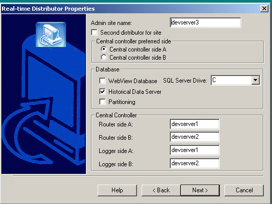

Have you configured the real-time distributor correctly? It should see both sides of the router and logger - see Central Controller config in the Setup. JPG attached.
Regards,
Geoff
Hi Geoff,
The configuration of real-time distributor is nearly same. There is only one differance, I have installed the AW's on same machine with Router and Logger. Therefore value for adminsite name and value for Router Side A are same.
