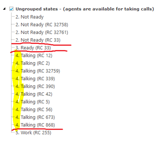

Client is using a 3rdParty reporting solution (Teleopti) to pull reports. The dip is pulling Talking reason codes - but I can't find a list of these RC so we can update the definitions. If talking should be a reason code of 0, or something else, are RC's being carried along when they are not supposed to be? If so, is this preventable?

You can find the reason code and text description for each in Finesse Administration > Reasons
Not_ready, Wrap up, and SignOut are all visible under the Finesse Reasons tab... Not Talking.
hence the confusion
