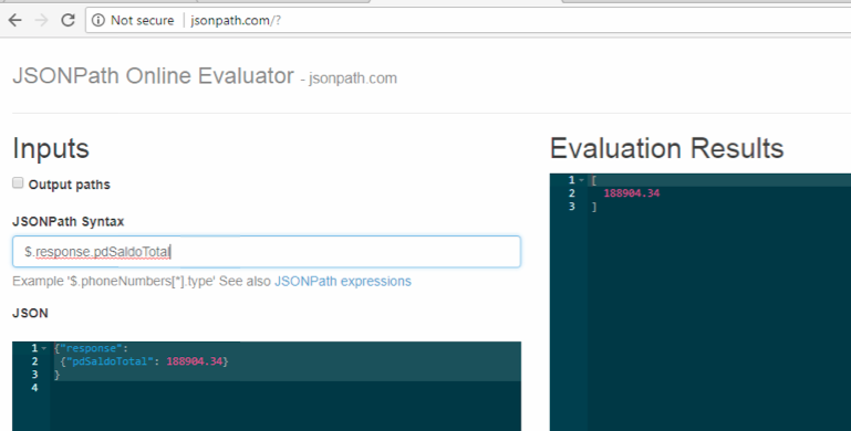

Thanks a lot Anthony.
The jsonon Path that you recomend worked. It send me the value I want.
this is the $.response.pdSaldoTotal

Here is the jshon path:

Hi Anthony,
We already did some tests and we detect this difference in the http_response
Customer WebService Response:
TEXT[{\"response\":{\"pdSaldoTotal\":188904.34}}]
With your example the response is:
TEXT[{\"response\":{\"pdSaldoTotal\":\"188904.34\"}}]
In your http_response you are adding these characters \"
Attached is the error that UCCX is displaying
Thanks
Hi Anthony,
We just change the variable type from string to float and works. -)
