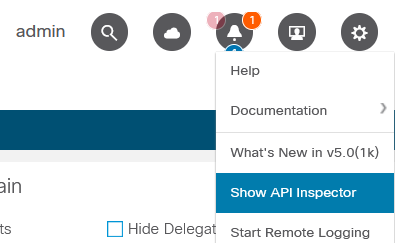

If you are asking me how I found out the correct URL to use, well I used API Inspector. You start the API inspector:
Then you opened the System Dashboard page, and voila:
