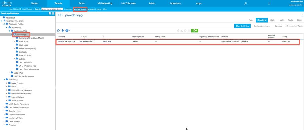

1. VRF provider-vrf has been created with Bridge Domain(BD) provider-bd. The endpoint 10.10.20.1 has been learned in EPG provider-epg through leaf 201/1/11.jpg

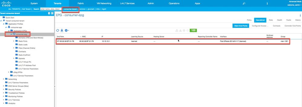

2. VRF consumer-vrf has been created with Bridge Domain(BD) consumer-bd. The endpoint 10.10.10.1 has been learned in EPG consumer-epg through leaf 201/1/172.jpg

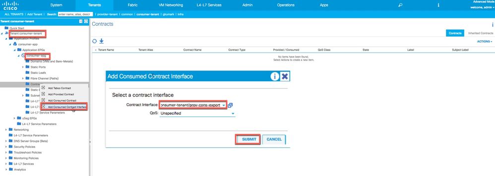

Step6: Apply above exported global contract as consumed contract interface under the consumer-vrf10.jpg

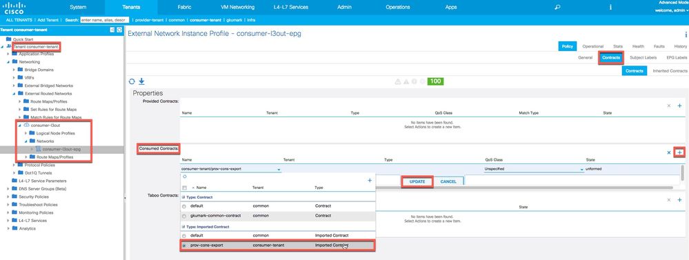

Step2: Under the l3out EPG in consumer-tenant, apply the consumed contract interface that was imported from provider-tenant. 15.jpg
