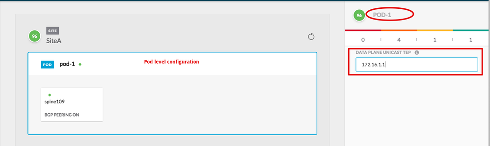

Sites __ CiscoMS 2018-09-04 18-27-02.png5. Next, let's click on the Pod area and go to the POD level specific policies.
Here we need to specify the Data Plane Unicast TEP, as shown below.

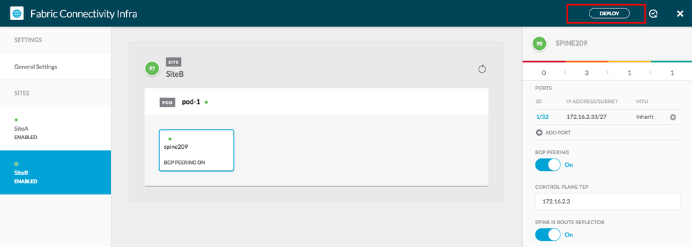

6.  Then click on the Spine area and go to Spine specific infra settings, here we can configure followings (as shown in the screenshot below):
For each interface from spine towards to IPN Switch, set IP address and mask,
BGP peer on (yes),
Control Plane TEP (Router Id),
Spine is Reflector (On)
7. Repeat the steps above for other sites and complete the infra configuration in MSC.
8. Click on the "DEPLOY" button at the top,  and this will push the infra configuration to APICs in both sites.
