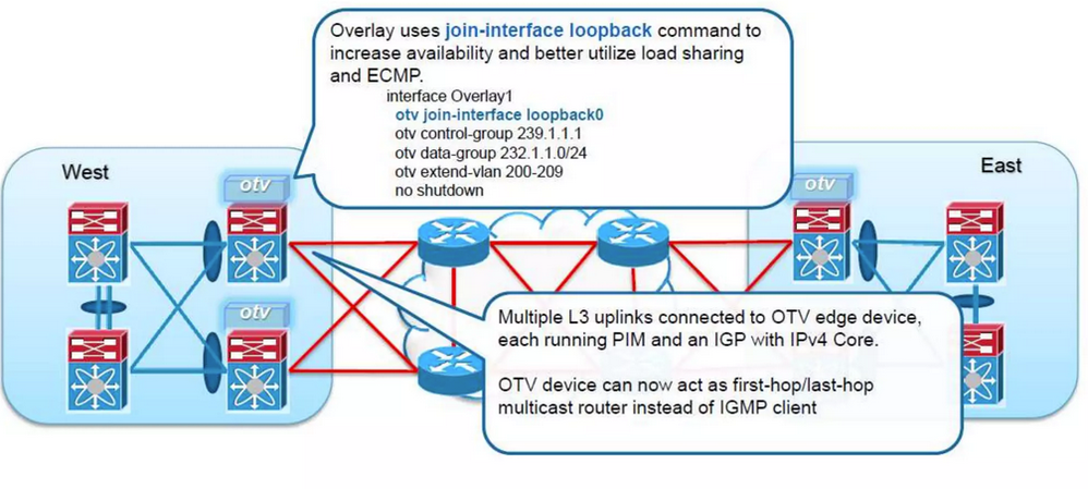

If is going directly to OTV VDC, then most likely your current configured join interface is a layer 3 physical port. If you want to add a new provider, then you must change the config and use a loopback as your join interface. Something like that:
This feature was not from the beginning of OTV. So yeah, depending on when OTV was implemented in your network, then it might not have been supported at that time.
EDIT: if you plan on using loopbacks as join interface, make sure you configure a secondary IP for depolarization.  If you have two edge devices in an overlay network, then each edge device is configured with two IP addresses.
