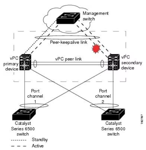

According to the link below,  why do we need to use a separate switch when we use the management interface and vrf managment to create a vpc peer-keepalive link?
https://www.cisco.com/c/en/us/td/docs/switches/datacenter/nexus9000/sw/6-x/interfaces/configuration/guide/b_Cisco_Nexus_9000_Series_NX-OS_Interfaces_Configuration_Guide/b_Cisco_Nexus_9000_Series_NX-OS_Interfaces_Configuration_Guide_chapter_0111.html
We recommend that you associate a peer-keepalive link to a separate virtual routing and forwarding (VRF) instance that is mapped to a Layer 3 interface in each vPC peer device. If you do not configure a separate VRF, the system uses the management VRF by default. However, if you use the management interfaces for the peer-keepalive link, you must put a management switch connected to both the active and standby management ports on each vPC peer device (see figure).
No data or synchronization traffic moves over the vPC peer-keepalive link; the only traffic on this link is a message that indicates that the originating switch is operating and running a vPC.

When running the vPC Peer-Keepalive Link over each vPC peer's management interface on modular/chassis switches (e.g. Nexus 7000, Nexus 9500, etc.), it is highly recommended to connect the management interfaces to a separate, out-of-band management switch. This is because each modular/chassis switch may have two supervisors, and only one supervisor will be active at a time. If the management interface of each supervisor is directly connected to the management interface of the remote vPC peer's supervisor, connectivity through the vPC Peer-Keepalive Link may be broken if there is a mismatch between which supervisor is active on either chassis.
This is best demonstrated through an example. Let's say you have two Nexus 9508 switches, N9K-1 and N9K-2, that form a vPC domain. Each switch has two supervisors inserted - one in slot 27, and the other in slot 28. The management interface of N9K-1's supervisor in slot 27 is directly connected to the management interface of N9K-2's supervisor in slot 27. Similarly, the management interface of N9K-1's supervisor in slot 28 is directly connected to the management interface of N9K-2's supervisor in slot 28. Let's assume that the active supervisor of both chassis is the supervisor inserted in slot 27.
As part of normal operations (upgrading the NX-OS software of either switch, replacing hardware, reloading the switch to test failover capabilities, etc.) the active supervisor of either chassis may change from the supervisor in slot 27 to the supervisor in slot 28. The standby supervisor is not capable of sending or receiving packets on its management interface, since it's not the active supervisor. If N9K-1 is upgraded and the supervisor in slot 28 becomes the active supervisor, connectivity through the vPC Peer-Keepalive Link will fail since N9K-2's supervisor in slot 28 is the standby supervisor, not the active supervisor. Thus, N9K-1's active supervisor in slot 28 has no way to connect to N9K-2's active supervisor in slot 27.
On its own, the vPC Peer-Keepalive Link going down will not cause any operational changes in the vPC domain. However, if the vPC Peer-Keepalive Link is down, and then the vPC Peer-Link goes down, that can cause both vPC peers to assume the other has gone down, causing a vPC split-brain scenario. vPC split-brain scenarios can cause a variety of odd connectivity issues within the network, which is obviously undesirable.
The solution to this issue is to ensure the management interface of both supervisors on both vPC peers are connected to an intermediary switch. Since the management interfaces are typically used for management purposes (SSH, SNMP, syslog, etc.) this switch is typically part of a larger out-of-band management network for the entire data center. With this solution, either supervisor can be the active supervisor of its respective chassis at any given time, and connectivity through the vPC Peer-Keepalive Link will remain stable.

I think this is also one of the possible reasons.However,  it seems that the statement of Christopher has more basis. Because the picture in the Cisco Document specially distinguished the active & standby link.
His basis is that he is telling you about a 9500 with multiple supervisors and multiple management links. The 9500 can do ISSU without issue and the supervisor links will be active or standby depending on which supervisor is active or standby.
