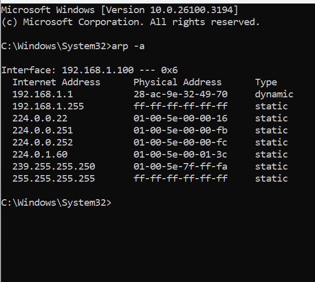

Just to be sure, your setup is this one:
RV325------------------PC
There is nothing else connected to the RV325. Can you share the outputs of the following commands from your PC when it's connected to the LAN port of the RV325:
netstat -nr
arp -a
ipconfig
Regards, LG
*** Please Rate All Helpful Responses ***
[image: image.png]
[image: image.png]
[image: image.png]
Above are the outputs.
Regards,
The images didn't attach properly - it's only a placeholder.
Regards, LG
Sorry about that.
sydney-vwalika
sydney-vwalika
Hope you will be able to view the screenshots now.
Regards
