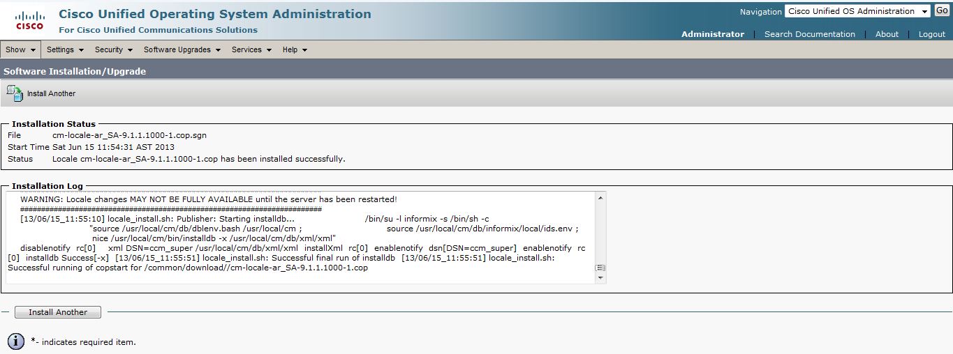

Ok Aman,
I have uploaded the files suggested by you on both the nodes pub and sub and followed the steps mentioned in the second link provided by you
Please find the screen shot
kindly let me know how i can change the language on the ip phone
Regards
Malik

Hi Aman,
Please find attached the screen shoot.
I have restarted the tftp do i need to restart the whole server as well ?
Regards,
Malik
