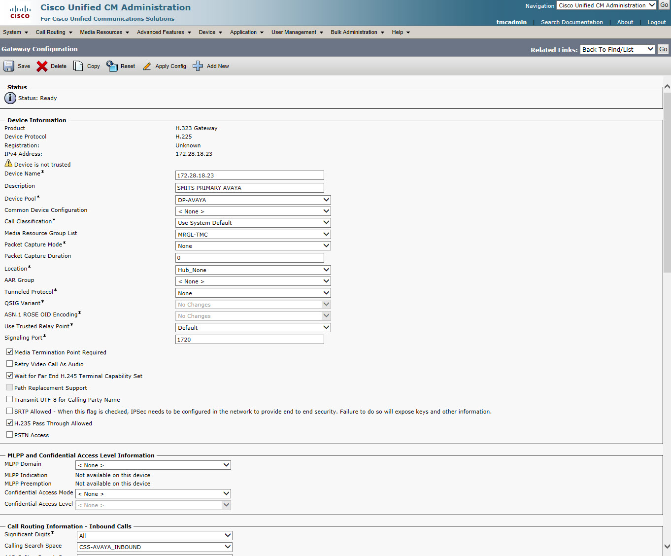

We are experiencing intermittent issue on calls between Avaya and Cisco, On failed calls, call will connect with no audio on both sides then after a few seconds it will automatically dropped. We configured the Avaya CM6 as an H323 gateway on the CUCM. Trusted relay point is enabled on H323 gateway using a registered MTP resource from the voice gateway. On successful calls, I am seeing a remote port and remote ip(the IP address of AVAYA resource) upon issuing show sccp connections and show voip rtp connections on VG. but on failing calls, remote port and remote ip is 0 and 0.0.0.0. Anyone familiar with this issue? Thank you

Thanks for your reply, the problem is their current Avaya system is not capable of using SIP trunk. that's why we opted to use H323. This is a direct integration without Voice Gateway in between, Our CUCM only use the Voice gateway as a MTP resource.

Thanks for your suggestions. 1. Actually we are using g729 on the integration since this is already the setup they are using and this is going thru MPLS. 2. We already checked the required MTP on the H323 configuration. 3. I checked on the CDR and I see cause value of 47 which indicate ,Resource unavailable. this is my config on the router:

as of now, I am the only one using the connection to Avaya. I have attached the sample output of the sh sccp conn
