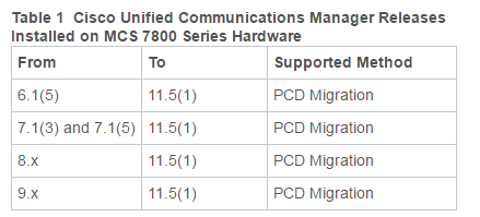

1) You do not need to invest additional cost for PCD. its free.
2) Yes you can follow the upgrade and migration doc for 11.5 and proceed with the RU.
Please keep the following things in mind:
if 9.X on MCS
if 9.X on Virtual Machine
COP files required before upgrading to 11.5
Please rate and mark correct if helpful

Thanks Adarsh for quick response.
We are looking for upgrading CUCM 9.X to CUCM 11 .
1. We do not want to invest in PCD as i assume we need to buy license for PCD. Please confirm.
2. Do we have any other option except PCD like RU upgrade ? Could you please point me in detailed doc ?
if 9.X on MCS
Regards,
Adarsh Chauhan
Regards,
Adarsh Chauhan
