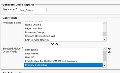

I'm still learning SQL queries myself, so I don't have a query that will give you what you are looking for. But another way to obtain the information would be to run a "Generate User Reports" out of BAT. You can list all of the information you mentioned. Once you have the CSV file, pull it into Excel and sort on the "Enable User for Unified CM IM and Presence" column.
I'm adding a screen cap of the Generate User Reports. The field "Access Control Group" is added below "Primary Extension", although you can't see it.
