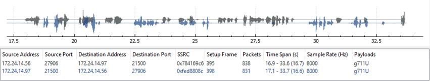

  1. Below is the snap of bidirectional audio stream generated by both the IP Phones. Spikes in the below snapshot is actual audio stream. It is playable properly.

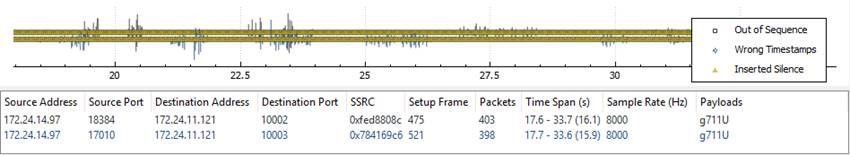

  1. When it comes to sending RTP packets to NICE Recording Server -
Phone is sending RTP packets over network properly but due to some network issue almost half of the RTP packets are getting lost in the network and only half of the RTP packets are reaching NICE Recording server.

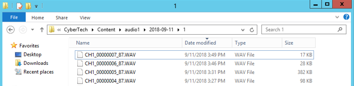

We can see these broken recording files generated on NICE recording server as well.  Below is the snapshot.
You can see the packet loss on snap in 1st point.

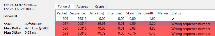

  1. The broken RTP packets reaching to the NICE Recording server are having wrong sequence number and are not playable on NICE Recording Server.
