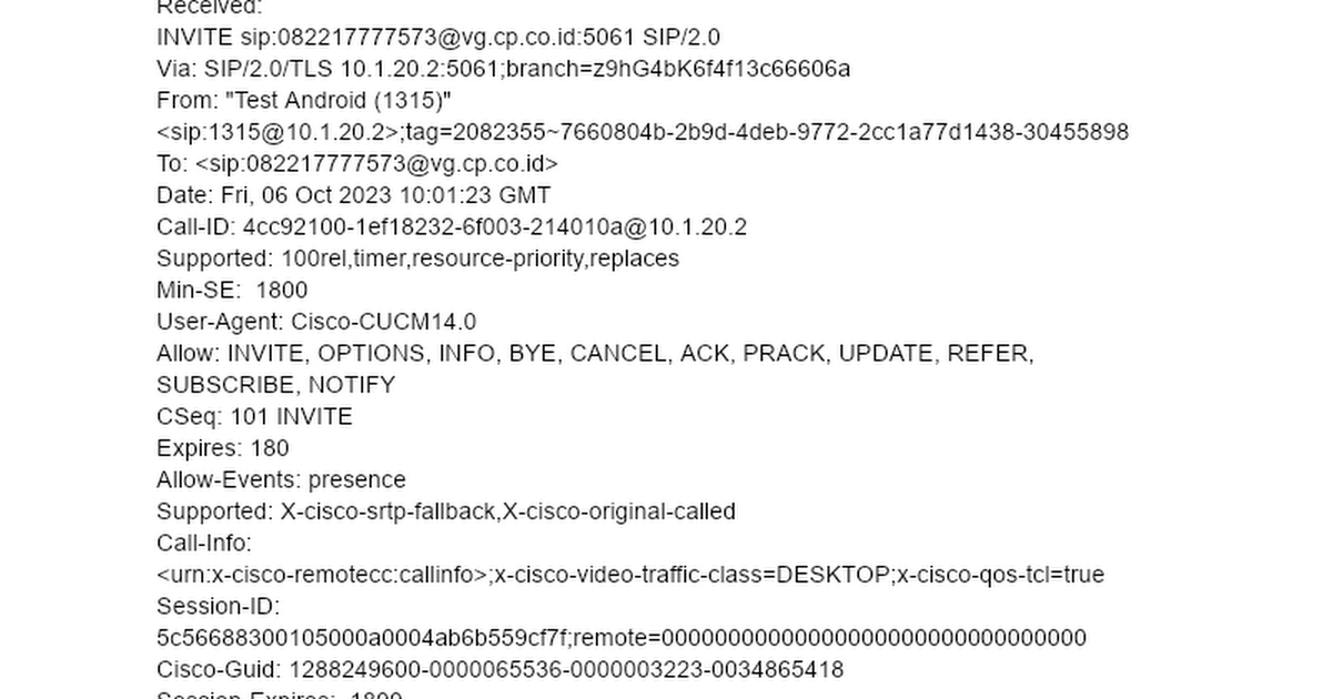

The issue is outbound PSTN call from ip phone/jabber to mobile phone is not working.
In the mobile phone, we could see the incoming call showing but it's gone before we can pick up the call.
IP Phone/jabber --TLS-SRTP--> CUCM --TLS-SRTP--> CUBE --TCP/UDP--> ITSP --> Mobile phone
Calle number 1315
Called number 90822xxxx7573
We use TLS-encrypted SIP for all except for the SIP trunk toward ITSP.
Internal ext call working fine.
SIP trunk status between CUCM and CUBE is full service.
CUCM 10.1.20.2 | cucm.cp.co.id
CUBE 10.1.3.232 | vg.cp.co.id
ITSP 10.14.3.221
Debug logs -> Logs
Thank you
n CPID~VG(config)#debug ccsip ^ % Invalid input detected at '^' marker. CPID~VG(config)#exit CPID~VG#debug ccsip message SIP Call messages tracing is enabled CPID~VG#debug voice ccapi inout voip ccapi inout debugging is on CPID~VG#term mon CPID~VG# 000666: Oct 6 10:01:23.904: ...

About the logs:
According to the logs, the CUCM is cancelling the call. So you have to check the logs of CUCM.
