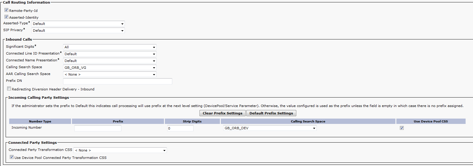

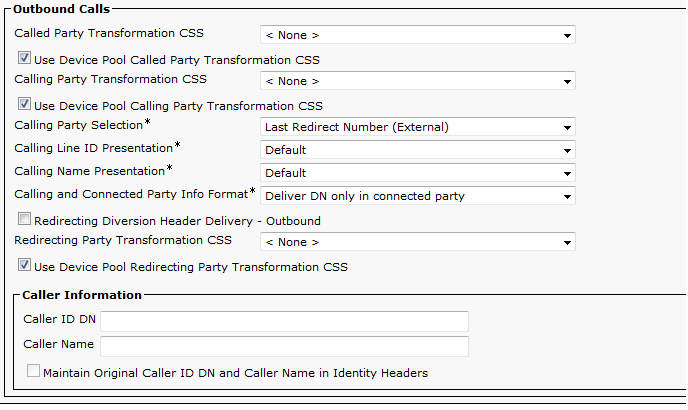

Thanks for your reply Carlo.  Can you suggest the settings I should be looking at?  Would it be the Trunk itself or the SIP Profile that may be at fault.  I have double checked it with other SIP Trunks I have configured and the settings seem very similar, however this is the only CUBE Trunk I have worked on.
Hi Robert.
Can you please post a screenshot of your trunk configuration?
Thanks
Regards
Carlo
Please rate all helpful posts "The more you help the more you learn"
Hi Carlo,
Please see attached screenshots.  Have broken them up into sections.
Thanks
Rob
