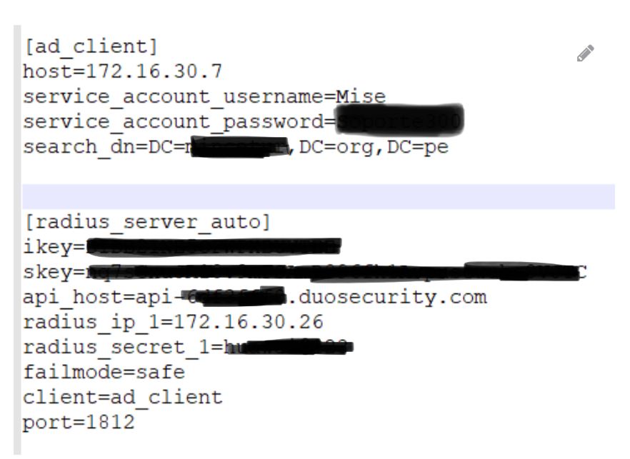

Hola, ¿es posible habilitar PAP con comunicación con Duo Prsoxy y Ciso ISE?
En la documentación de Duo sobre Fortinet y Palo Alto, es posible activar la opción para especificar el tipo de protocolo que se utilizará para comunicarse con el proxy duo y el NAC, pero en Cisco Ise no encuentro esa opción.
Adjunto mi proxy settings.cfg
registros de Cisco Duo
La configuración que tengo en ISE es:
Usuario local creado especificando que es un usuario Duo.

First of all, you've attached a screenshot of your real config of your duo proxy which includes your keys. Remove the screenshot and reattach it by hiding these keys.
Why on ISE are you creating a network access user?
PAP is available on authentication protocol. Normally ISE receives an authentication request and forward it to your DUO using the protocol. Is this what you want to do?
Answer: Yes, I want to do that, but acordly the logs, I need PAP authentication between ISE and Duo proxy and I can’t find the option for set PAP authentication because I set up radios external(duo)
this is the Web page that i follow:
https://duo.com/docs/ciscoise-radius
I need 802.1x authentication
The doc you're looking at is specially for vpn where authentication will be in pap by default.
For 802.1x, you'll need to use saml and so have duo as gateway but not the way you're implementing it.
As far as i know, duo proxy doesn't support mschapv2.
