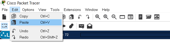

jaydhani.42
I am more than 1 year late , but i found a solution to this problem. It is unfortunate i would not be the accepted answer of this question , but i hope that people looking for solution to this problem will be fortunate enough to scroll down this page deep enough to see this answer.
So if you login with guest account , created a huge project , and forgot you reached your guest limit , and for unknown reason the app does not give you a way to login to remove the guest account , and then you thought you hit an unfortunate fate where you must exit the app and delete your huge project in order to reopen the app to login with account and recreate your huge project from SCRATCH , contemplating life in the process ........
Don't worry ! i have a work around to this problem:
1. Just run the packet tracer again without exiting the previous packet tracer . Now you have 3 window , 1 is your huge project , 1 is empty project , and 1 is the login page .
2. Login your account in the window in the login page.
3. Done ! The window will be closed once you logged in , and now you have two window , 1 is your huge project , and 1 is empty project.
4. Then you try to save on the window with your huge project...... just for the guest save limit popup to appear again. To solve this , select EVERYTHING in your huge project , press Ctrl+C in your keyboard to copy your selection (or go to Edit -> Copy) .
5. Go to the empty project window and press Ctrl+V in your keyboard to paste what you just copied (or go to Edit > Paste)
6. Now you have two window which contains your huge project !!! One window is logged in as guest which cannot save , and the other is window with logged in account which you can save . After pasting your huge project , check if there is any error , and fix it . If there is no error anymore , you can now safely exit the window that is logged in as guest account since you no longer need it, then save your project in the window with logged in account.
Definitely not me who spent more than 45 minutes to write this in midnight . Seriously , i still cannot understand why can't we re-login after logging in as guest ??
Thank you so much for the help!
