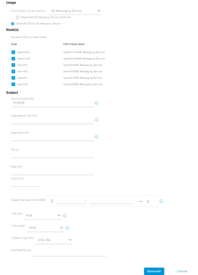

We could not reimport the ISE Messaging Service certificate on the new equipments.
Can this have an impact on the logs knowing that the option [Use "ISE Messaging Service" for UDP Syslogs delivery to MnT ] is disabled?
this could not be done because on the new PSN, the ISE Messaging Service certificate used has a different domain name
  1. Navigate to Administration > System > Logging.  You should see that Use ISE Messaging Service for UDP Syslogs delivery to MnT is enabled.  This is a new feature that was released in ISE 2.6 and I have run in to this issue.  You may need to regenerate these certificates after an upgrade.
  2. To fix this you need to generate new deployment-wide signed certificates.  This is a simple process that can be done by navigating to Administration > System > Certificates and choosing Certificate Signing Requests from the left menu
  3. Click the button for Generate Certificate Signing Requests (CSR)
  1. In the Usage field, select that the Certificate(s) will be used for ISE Messaging Service
  1. Since this is an upgrade, ISE Messaging may not have been enabled previously, you need to select Generate CSR for ISE Messaging Service
  2. Select ALL the ISE Nodes and fill out the certificate fields
  1. Of course, you should follow any guidance and troubleshooting from the Cisco Identity Services Engine Upgrade Guide, Release 2.7
