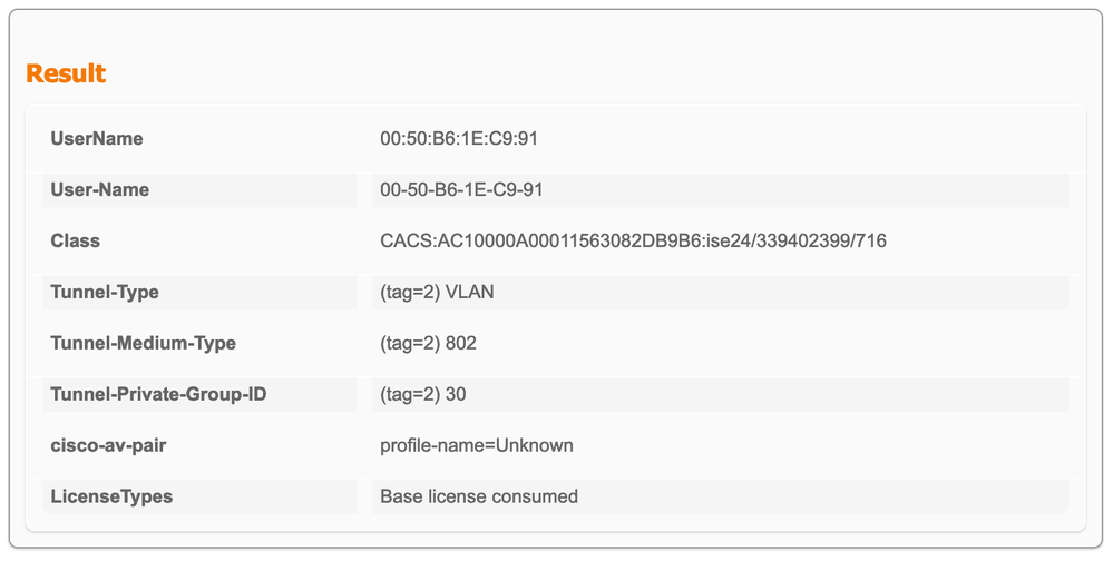

I wonder if there is ghost attributes being sent. Can you go to the details of the live log event for specific endpoint and look at the 'Result' section. You should see it at the bottom of the report. For my VLAN assignment I only see the 3 attributes. If you see additional attributes here for reauth then you may need to delete the authorization profile and recreate it. The other thing I would try is do a 'shut/no shut' in the interface to clear any previous settings (Although I doubt will make any difference would suggest to start cleanly).
